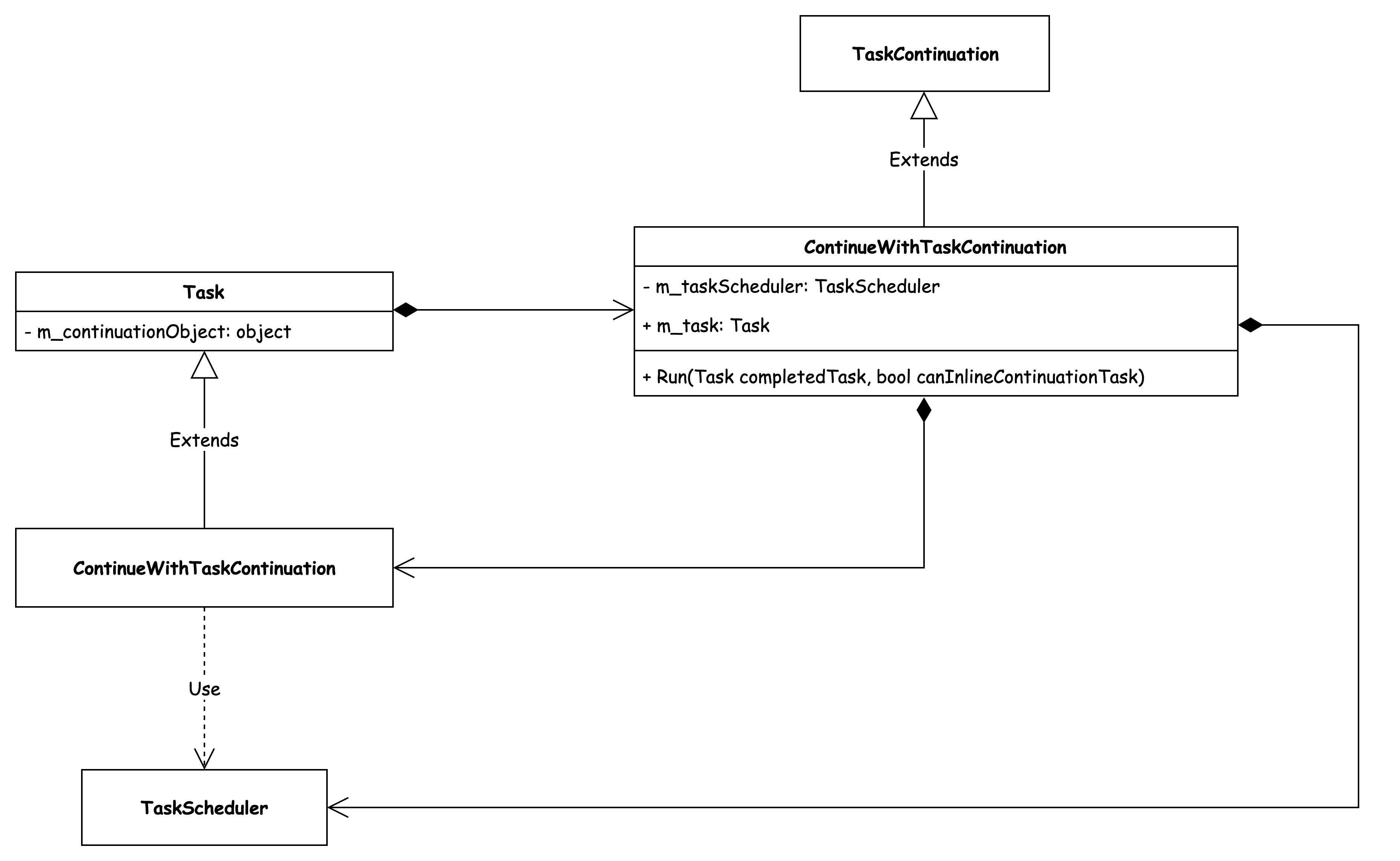

ContinueWithTaskContinuation 的父类 TaskContinuation 是一个抽象类。除了 ContinueWithTaskContinuation,还有别的实现。
internal abstract class TaskContinuation
    internal abstract void Run(Task completedTask, bool canInlineContinuationTask);
ContinueWithTaskContinuation 维护着 Task 执行相关的两个核心对象,一个是 Task 本身,另一是 TaskScheduler。真正执行回调之前,需要先调用 TaskContinuation.Run。
internal sealed class ContinueWithTaskContinuation : TaskContinuation
    internal Task? m_task;
    internal readonly TaskContinuationOptions m_options;
    private readonly TaskScheduler m_taskScheduler;
    internal ContinueWithTaskContinuation(Task task, TaskContinuationOptions options, TaskScheduler scheduler)
        m_task = task;
        m_options = options;
        m_taskScheduler = scheduler;
    internal override void Run(Task completedTask, bool canInlineContinuationTask)

回调执行真正的决定者:ContinueWithTaskContinuation
在 ContinueWithTaskContinuation 中维护着待执行的 ContinuationTask 以及决定 ContinuationTask 最终执行方式的 TaskContinuationOptions 和 TaskScheduler。
        m_task = task;
        Task? continuationTask = m_task;
        m_task = null;
        // 检查任务的完成状态,如果不符合 TaskContinuationOptions 的设置,回调就不会被执行
        TaskContinuationOptions options = m_options;
        bool isRightKind =
            completedTask.IsCompletedSuccessfully ?
                (options & TaskContinuationOptions.NotOnRanToCompletion) == 0 :
                (completedTask.IsCanceled ?
                    (options & TaskContinuationOptions.NotOnCanceled) == 0 :
                    (options & TaskContinuationOptions.NotOnFaulted) == 0);
        // 任务完成状态符合要求,回调执行。
        if (isRightKind)
            continuationTask.m_taskScheduler = m_taskScheduler;
            // 直接执行回调或将其排队等待执行,具体取决于是否需要同步或异步执行。
            // 默认执行路径,上层传的是 true。
            if (canInlineContinuationTask && // 调用Run方法的内部方法传了允许内联
                (options & TaskContinuationOptions.ExecuteSynchronously) != 0) // 注册回调的实际用户设置了同步执行
                InlineIfPossibleOrElseQueue(continuationTask, needsProtection: true);
            else
                try { continuationTask.ScheduleAndStart(needsProtection: true); }
                catch (TaskSchedulerException)
                    // 如果 Task 执行失败了,ScheduleAndStart 方法会将 Task 标记为失败,
                    // 这里是runtime设计的时候保证不会有意外的错误发生,仅做catch,不做处理
        else
            Task.ContingentProperties? cp = continuationTask.m_contingentProperties;
            if (cp is null || cp.m_cancellationToken == default)
                continuationTask.InternalCancelContinueWithInitialState();
            else
                continuationTask.InternalCancel();

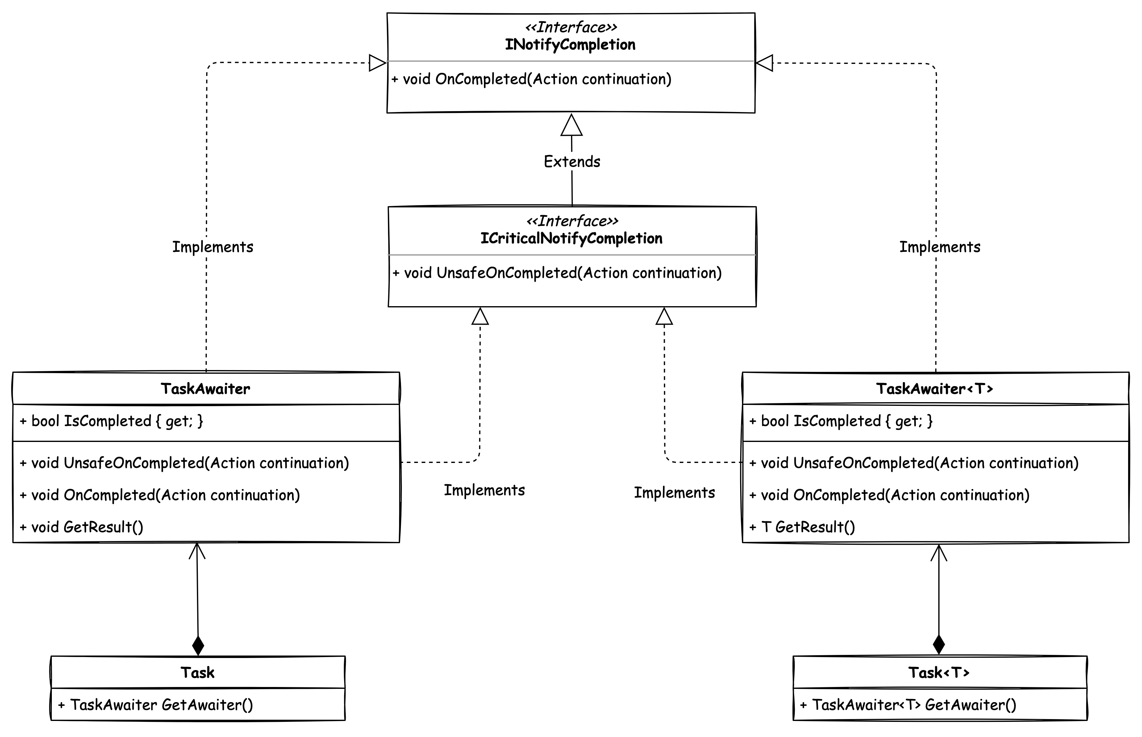

await Anything
C# 编译器并没有限制 await 关键词只能用在 Task 上。例如 Task.Yield() 的返回值 YieldAwaitable,既不是 Task 也不是 Task 的子类。
public readonly struct YieldAwaitable
    public YieldAwaitable.YieldAwaiter GetAwaiter() => new YieldAwaitable.YieldAwaiter();
    public readonly struct YieldAwaiter :
        ICriticalNotifyCompletion,
        INotifyCompletion
        public bool IsCompleted => false;
        public void OnCompleted(Action continuation) => YieldAwaitable.YieldAwaiter.QueueContinuation(continuation, true);
        public void UnsafeOnCompleted(Action continuation) => YieldAwaitable.YieldAwaiter.QueueContinuation(continuation, false);
        public void GetResult()
Task 和 YieldAwaitable 都提供了一个 GetAwaiter 方法。
返回的 XXXAwaiter 需满足以下两个条件:
  1. ICriticalNotifyCompletion,INotifyCompletion 这两个接口。而 ICriticalNotifyCompletion 是 INotifyCompletion 的子接口。
public interface INotifyCompletion
    void OnCompleted(Action continuation);
public interface ICriticalNotifyCompletion : INotifyCompletion
    void UnsafeOnCompleted(Action continuation);
  1. 提供 IsCompleted 属性 和 void GetResult() / TResult GetResult() 方法。GetResult 方法是否有返回值取决于 await XXXAwaitable 是否想提供返回值。
实际上,我们自己想要实现一个 Awaitable 的话,Awaiter 只需要实现 INotifyCompletion 接口或者 ICriticalNotifyCompletion 就可以了。

一旦实现了 ICriticalNotifyCompletion(INotifyCompletion 的子接口),注册回调走的是 UnsafeOnCompleted 方法。如果同时实现两个方法,也还是以ICriticalNotifyCompletion 的规则优先。
INotifyCompletion VS ICriticalNotifyCompletion
既然实现 Awaitable 只要实现两个接口之一,那为什么要区分出这两个接口呢。
我们来看看 TaskAwaiter 里的实现是什么样。
public readonly struct TaskAwaiter<TResult> : ICriticalNotifyCompletion, INotifyCompletion

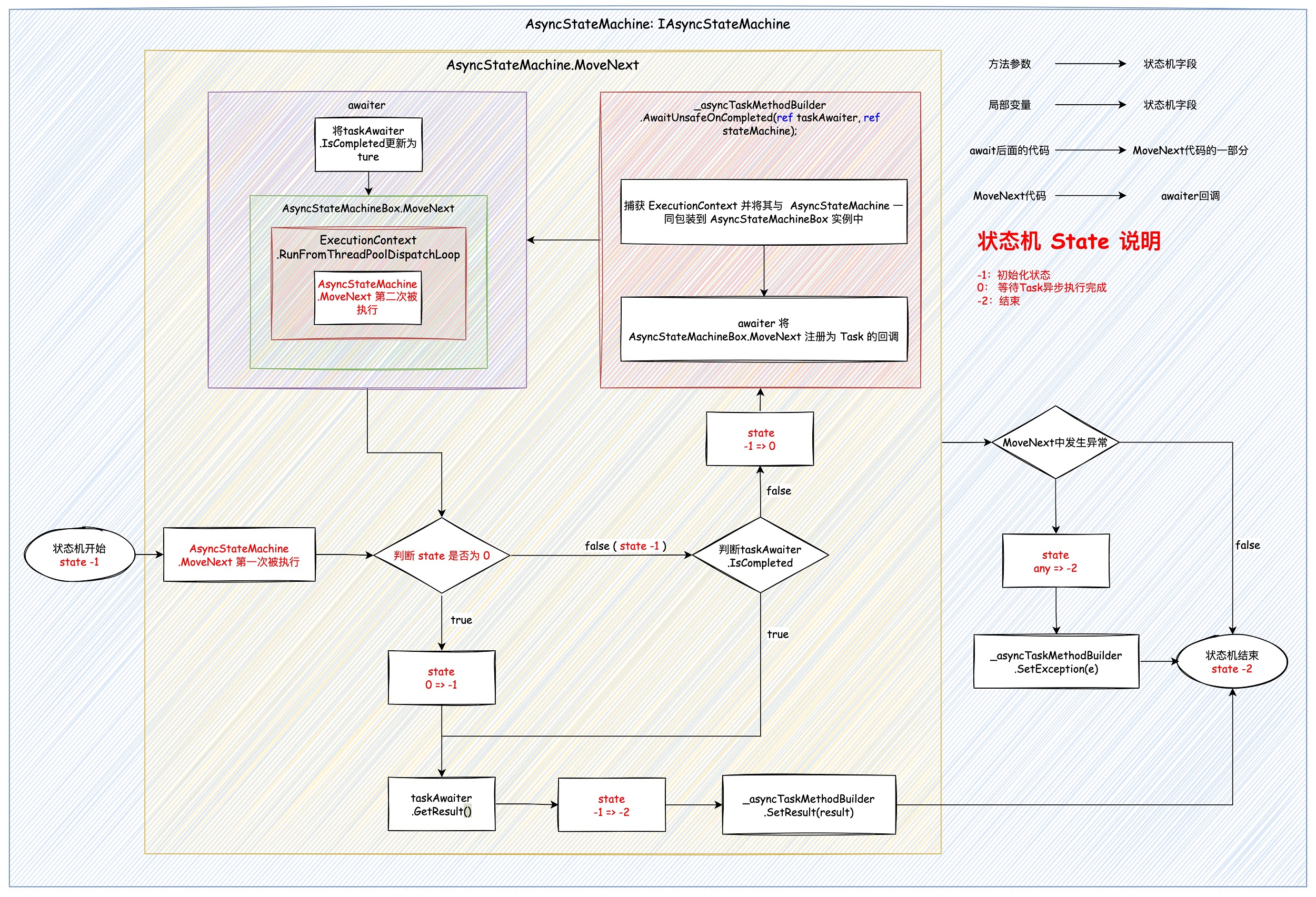

也就是说 OnCompleted 会保证 ExecutionContext 往后传播。而 UnsafeOnCompleted 则不会。我们来看下面这个示例。
class Program
    private static readonly AsyncLocal<string> AsyncLocal = new AsyncLocal<string>();

如果使用了 UnsafeOnCompleted 注册回调,也就是 flowExecutionContext: false,则 ExecutionContext 不会往后继续传播。
同一个 Task 回调执行前后线程没变是因为 TaskSchedulerAwaitTaskContinuation 里优先 Inline 执行回调,暂不展开。

如果像上文那样自己实现 Awaitable,会调用 TaskAwaiter.OnCompleted 或者 TaskAwaiter.OnCompleted 方法。这个和 AsyncMethodBuilder 内部的实现有关。(手动狗头,设计的太复杂了)

观察下面这么一个常见的 await 使用场景,可以将 FooAsync 方法内部的逻辑分为三种状态(即 三个阶段):
  1. 初始化状态
  2. 等待 BarAsync 执行完成的状态
  3. 执行结束状态

由 FooAsync 编译成的 IL 代码经整理后的等效 C# 代码如下:

编译器在 Program 中创建了一个内部类,也就是 FooStateMachine 这个状态机,而 FooAsync 方法则变成了对这个状态机的使用。
AsyncTaskMethodBuilder 的作用解释放到下一篇文章再解释,这边简单理解成 AsyncTaskMethodBuilder.SetResult 就是 FooAsync return 返回值,AsyncTaskMethodBuilder.SetException 就是 FooAsync 内部往外扔异常。
完整的流程如下图所示:
一个方法中就算有个 await,这个方法也只会有一个对应的状态机。就.NET 6 SDK 的编译结果来看,state 会出现 -1 => 0(等待第一个Task异步执行完成) => -1 => 0(等待第二个Task异步执行完成)这样的流程。
AsyncStateMachineBox
前文讲过 awaiter 往 Task 注册回调的逻辑里,可能不会直接传递 ExcutionContext。
而这个 AsyncStateMachineBox 是对 AsyncStateMachine 和 ExcutionContext 的包装,这边通过这样的方式往后传递 ExcutionContext。

回忆一下上文 Task.ContinueWith 讲回调最终封装到了 ContinueWithTaskContinuation。
返回值是 Task 的情况下状态机所绑定的 AsyncTaskMethodBuilder 的所会调用 Task.UnsafeSetContinuationForAwait 实例方法。里面会根据不同的条件创建不同的 TaskContinuation。
UnsafeSetContinuationForAwait 中的逻辑和后续回调执行流程大致如下:
