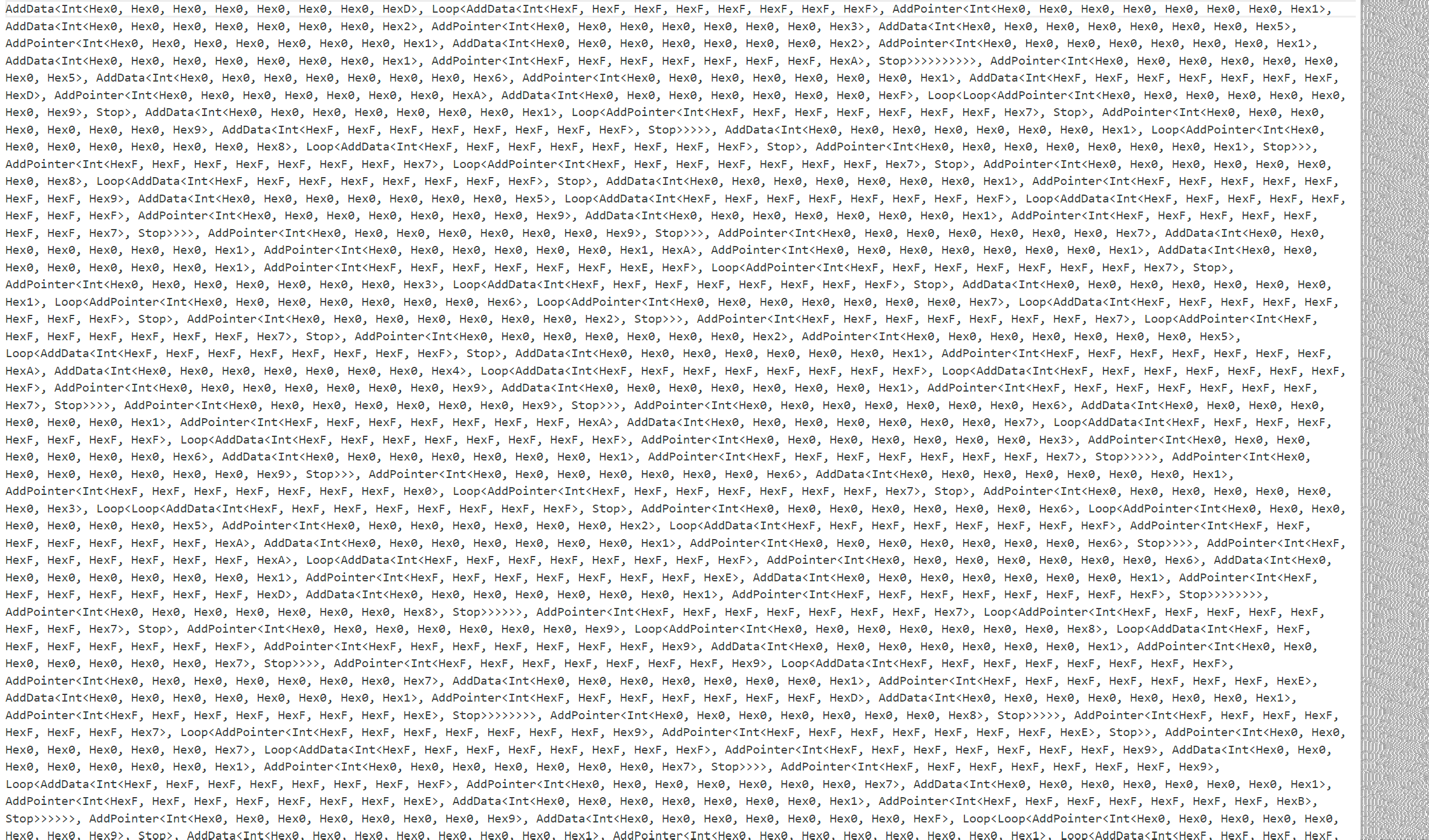

AddData<8, Loop<
    AddPointer<1, AddData<4, Loop<
        AddPointer<1, AddData<2, AddPointer<1, AddData<3, AddPointer<1, AddData<3, AddPointer<1, AddData<1, AddPointer<-4, AddData<-1, Stop>>>>>>>>>>,
        AddPointer<1, AddData<1, AddPointer<1, AddData<1, AddPointer<1, AddData<-1, AddPointer<2, AddData<1,
            Loop<AddPointer<-1, Stop>,
            AddPointer<-1, AddData<-1, Stop>>
    AddPointer<2, OutputData<AddPointer<1, AddData<-3, OutputData<AddData<7, OutputData<OutputData<AddData<3, OutputData<AddPointer<2, OutputData<AddPointer<-1, AddData<-1, OutputData<AddPointer<-1, OutputData<AddData<3, OutputData<AddData<-6, OutputData<AddData<-8, OutputData<AddPointer<2, AddData<1, OutputData<AddPointer<1, AddData<2, OutputData<Stop>>>>>>>>>>>>>>>>>>>>>>>>>>>>>>>

using HelloWorld = AddData<8, Loop<
    AddPointer<2, OutputData<AddPointer<1, AddData<-3, OutputData<AddData<7, OutputData<OutputData<AddData<3, OutputData<AddPointer<2, OutputData<AddPointer<-1, AddData<-1, OutputData<AddPointer<-1, OutputData<AddData<3, OutputData<AddData<-6, OutputData<AddData<-8, OutputData<AddPointer<2, AddData<1, OutputData<AddPointer<1, AddData<2, OutputData<Stop>>>>>>>>>>>>>>>>>>>>>>>>>>>>>>>;

这段程序编译出来的类型也是非常的壮观:
去掉所有空格之后类型名称足足有 165,425 个字符!
