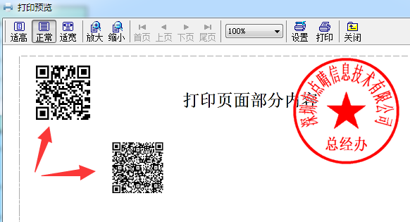

LODOP.ADD_PRINT_BARCODE(10,20,100,100,"QRCode","1234567");                 //第一个二维码
LODOP.SET_PRINT_STYLEA(0,"QRCodeErrorLevel","M");                          //M为中容错率15%,可不加上本句,默认为L
LODOP.SET_PRINT_STYLEA(0,"QRCodeVersion",3);                               //固定二维码标签大小,这句是关键
LODOP.ADD_PRINT_BARCODE(120,130,100,100,"QRCode","1234567内容可以包含汉字"); //第二个二维码
LODOP.SET_PRINT_STYLEA(0,"QRCodeVersion",7);                               //固定二维码标签大小,这句是关键
效果:
