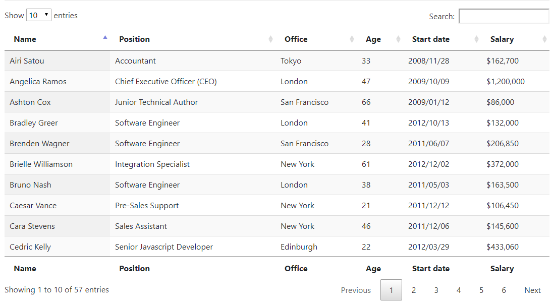

  1. 初始化Datatables
<table id="myTable" class="display" style="width:100%">    <thead>
        <tr>
            <th>Name</th>
            <th>Position</th>
            <th>Office</th>
            <th>Age</th>
            <th>Start date</th>
            <th>Salary</th>
        </tr>
    </thead>
    <tbody>
        <tr>
            <td>Ops Coffee</td>
            <td>System Architect</td>
            <td>Edinburgh</td>
            <td>18</td>
            <td>2011/04/25</td>
            <td>$320,800</td>
        </tr>
        <!-- 中间省略一些tr数据 -->
        <tr>
            <td>Donna Snider</td>
            <td>Customer Support</td>
            <td>New York</td>
            <td>27</td>
            <td>2011/01/25</td>
            <td>$112,000</td>
        </tr>
    </tbody>
    <tfoot>
        <tr>
            <th>Name</th>
            <th>Position</th>
            <th>Office</th>
            <th>Age</th>
            <th>Start date</th>
            <th>Salary</th>
        </tr>
    </tfoot></table>
$(document).ready( function () {
    $('#myTable').DataTable();
  1. 完成以上两步可以看到页面效果如下

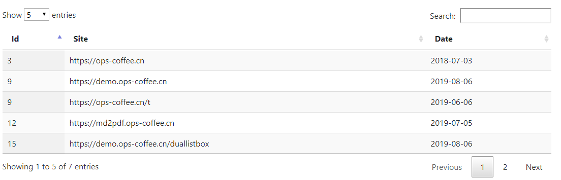

从数组中获取
<table id="myTable-x" class="display" style="width:100%"></table>
$(document).ready(function() {    var dataSet = [
      ["3","https://ops-coffee.cn","2018-07-03"],
      ["9","https://demo.ops-coffee.cn", "2019-08-06"],
    $('#myTable-x').DataTable({        "data": dataSet,        "columns": [
          { title: "Id" },
          { title: "Site" },
          { title: "Date" },
data: 指定数组
columns: 配置每一列的title
注意:从数组中获取数据一定要有表头,如果没有则可能会报下边的错:
Uncaught TypeError: Cannot read property 'aDataSort' of undefined
解决方法就是datatables添加columns配置,或者写上table的thead

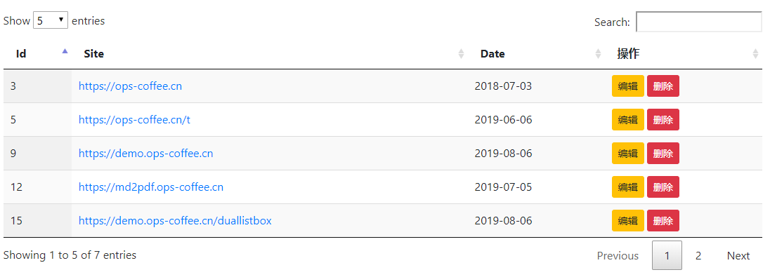

当然也可以通过columns在表格末尾添加一列以实现编辑、删除的按钮展示
"columns": [
    {"data": "id", "title":"Id"},
    {        "data": "site",
        "title":"Site",        "render": function (data, type, row) {          return '<a href='+data+' target="_blank">'+data+'</a>'
    {"data": "date", "title":"Date"},
      "data": "id",      "title": "操作",      "render": function (data, type, row) {        return '<a href="#update/'+row.id+'/" class="btn btn-warning btn-sm">编辑</a> ' +               '<a href="#delete/'+row.id+'/" class="btn btn-danger btn-sm">删除</a>'
最终呈现结果如下图

运行结果
